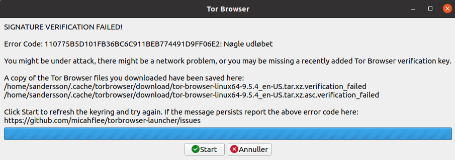

But no matter how i Try to install it (Software center, snap, Terminal commands, PPA 's etc), it is getting stuck in verifying signature after the download wizard has run.
Anyone know the solution to this problem?
SkĂŚrmbillede fra 2020-09-07 14-46-17

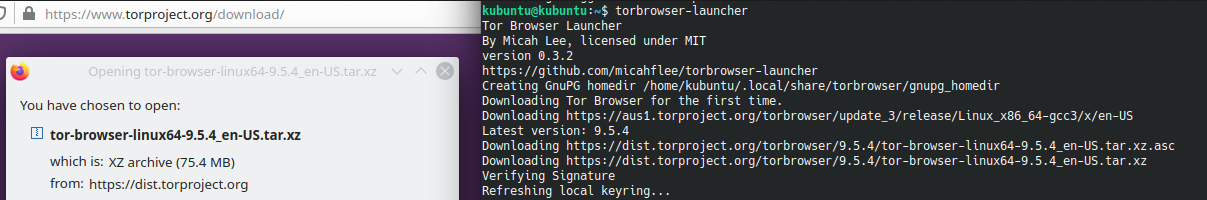

I can add, that I just tried to start the Tor browser in the Terminal by entering:
torbrowser-launcher
I gives the following output:
Tor Browser-opstarter
Af Micah Lee, licenseret under MIT
version 0.3.2
Downloader Tor Browser for første gang.
Downloader over Tor
Downloader https://aus1.torproject.org/torbrowser/update_3/release/Linux_x86_64-gcc3/x/en-US
Seneste version: 9.5.4
Downloader https://www.eprci.com/tor/dist/torbrowser/9.5.4/tor-browser-linux64-9.5.4_en-US.tar.xz.asc
Verificerer signatur
Refreshing local keyring…
Traceback (most recent call last):
File “/usr/lib/python3/dist-packages/torbrowser_launcher/launcher.py”, line 589, in verify
c.verify(signature=sig, signed_data=signed)
File “/usr/lib/python3/dist-packages/gpg/core.py”, line 541, in verify
raise errors.BadSignatures(results[1], results=results)
gpg.errors.BadSignatures: 110775B5D101FB36BC6C911BEB774491D9FF06E2: Nøgle udløbet
During handling of the above exception, another exception occurred:
File “/usr/lib/python3/dist-packages/torbrowser_launcher/launcher.py”, line 600, in run
verify()
File “/usr/lib/python3/dist-packages/torbrowser_launcher/launcher.py”, line 594, in verify
raise Exception
Exception
File “/usr/lib/python3/dist-packages/torbrowser_launcher/launcher.py”, line 603, in run
self.common.refresh_keyring()
File “/usr/lib/python3/dist-packages/torbrowser_launcher/common.py”, line 196, in refresh_keyring
p = subprocess.Popen([‘/usr/bin/gpg2’, ‘–status-fd’, ‘2’,
File “/usr/lib/python3.8/subprocess.py”, line 854, in init
self._execute_child(args, executable, preexec_fn, close_fds,
File “/usr/lib/python3.8/subprocess.py”, line 1702, in _execute_child
raise child_exception_type(errno_num, err_msg, err_filename)
FileNotFoundError: [Errno 2] Ingen sådan fil eller filkatalog: ‘/usr/bin/gpg2’
What I take away is the message saying “Nøgle udløbet” which is in English that the “key has expired”
But what does that means?

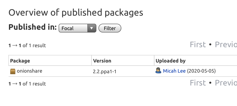

That PPA is out of date though.
What do you mean by out of date? I’m not a regular PPA user. I seem to be getting the latest version of torbrowser-launcher and Tor when I use it and it’s the one on their GitHub if that means anything.
I’m getting the same errors as @VikingPenguin though.
The PPA does not contain a version for 20.04. It’s pulling it in from the Ubuntu repositories.

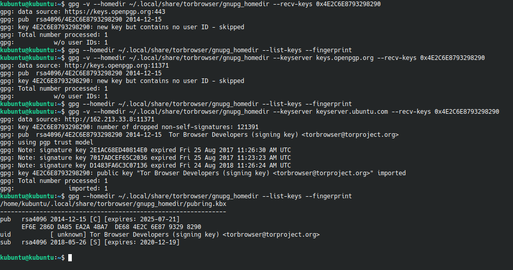

The gnupg home relevant to the installation isn’t the default: ~/.gnupg/, it’s: ~/.local/share/torbrowser/gnupg_homedir/
It’s created with appropriate permissions when torbrowser-launcher launches for the first time.
The default key server is keys.openpgp.org as seen when running:
gpg -v --homedir ~/.local/share/torbrowser/gnupg_homedir --recv-keys 0x4E2C6E8793298290
…and confirming the response from keys.openpgp.org:
gpg -v --homedir ~/.local/share/torbrowser/gnupg_homedir --keyserver keys.openpgp.org --recv-keys 0x4E2C6E8793298290
It gives the error: “new key but contains no user ID - skipped” and doesn’t install the key.
What’s interesting is when torbrowser-launcher reaches the end of it’s installation it’ll install a key so i’m not sure where it’s getting it from or if it’s forcing the inadequate key that’s coming from keys.openpgp.org.
The solution is to use a key from a different key server. Having tried:
  • keyserver.ubuntu.com
  • pgp.mit.edu
  • keys.gnupg.net
These all work with browser-launcher and Tor starts without a hitch.
Side note: With a functional key there’s no error for missing gnupg2.

It’ll begin to downloading Tor, during the download open another Terminal and install the correct gpg key:
gpg --homedir ~/.local/share/torbrowser/gnupg_homedir --keyserver keyserver.ubuntu.com --recv-keys 0x4E2C6E8793298290
It’ll take a few minutes for this to complete. Once the Tor download is complete browser-launcher will run Tor correctly.
